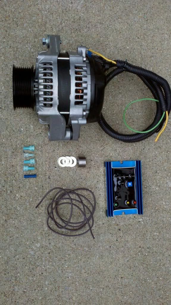

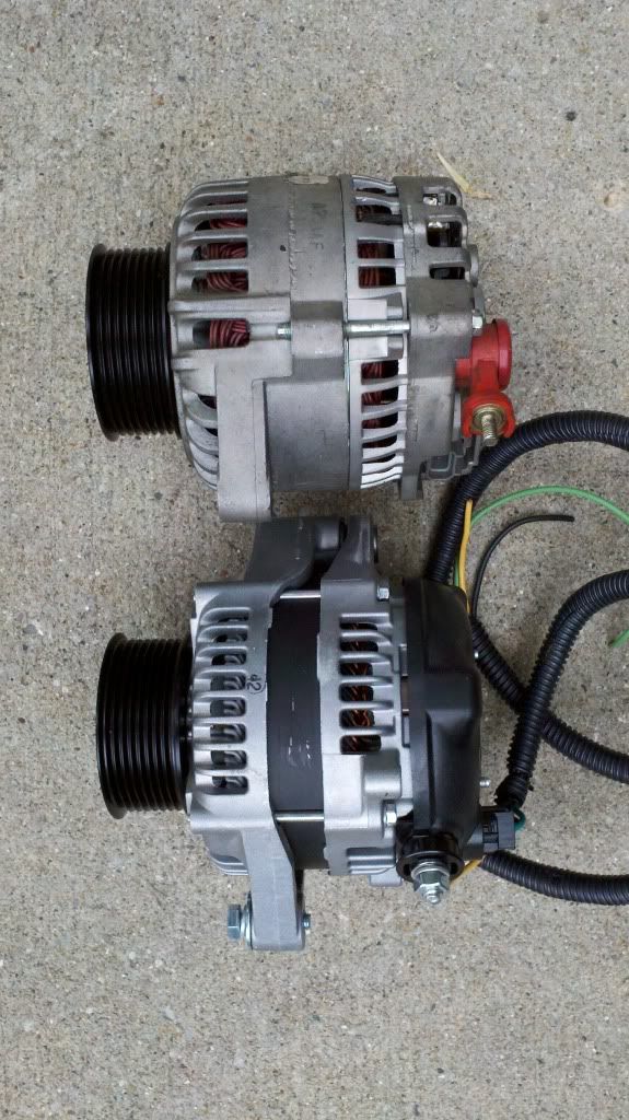

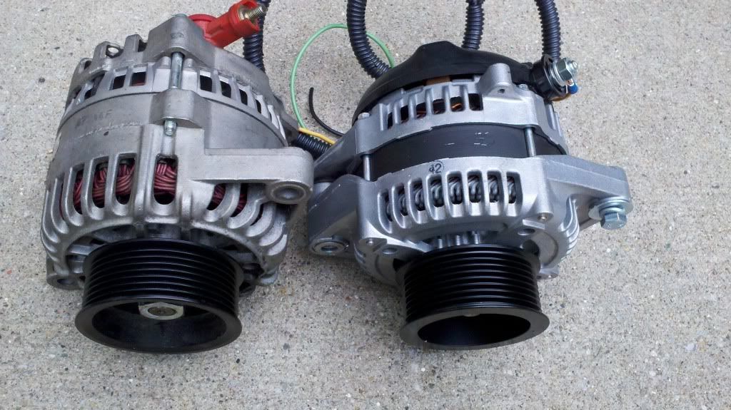

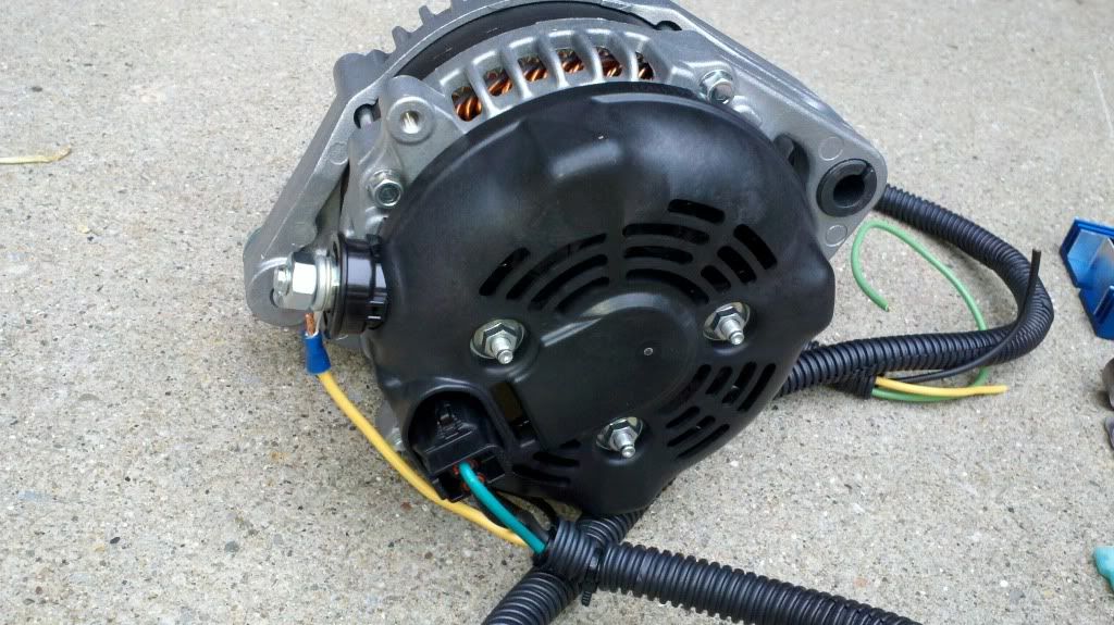

    Next to Stock::
    You are looking at a Nippendenso based unit. The front derives from an ambulance, and the rear comes from a Chrysler.
    Adam needed to use the Chrysler rear because that is the only style that can have a 'dummy' regulator installed in it.
    He also found me an OE 3.3" Pulley for it.
    He made the wire loom and supplied all connectors and instructions how to hook up the regulator. As shipped, its set to make 14.2 volts (and I verified that) I set it to 14.6.

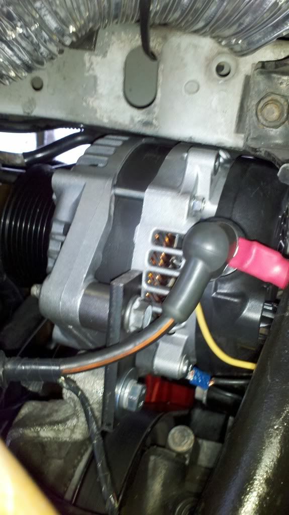

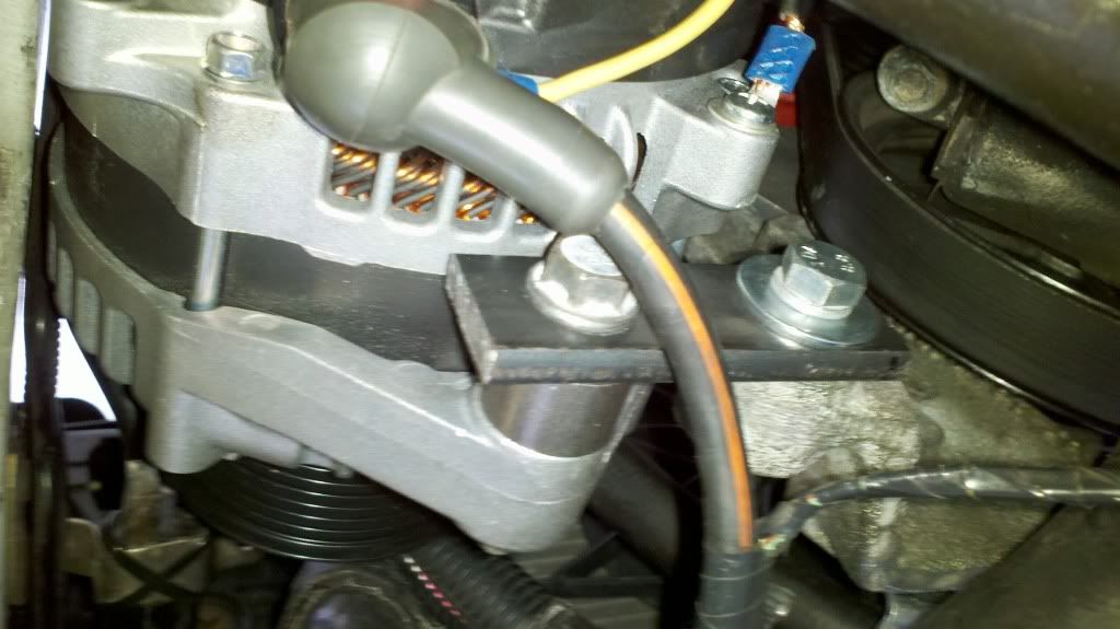

    Before I get to the test drive, you will have to make a simple bracket to secure the bottom mount, and its actually about 1/2" shorter than stock: (hole spacing is 1.625")
    Here is a top pic. (Adam supplied the correct spacers to correctly position the alternator, since the top leg is much shorter)

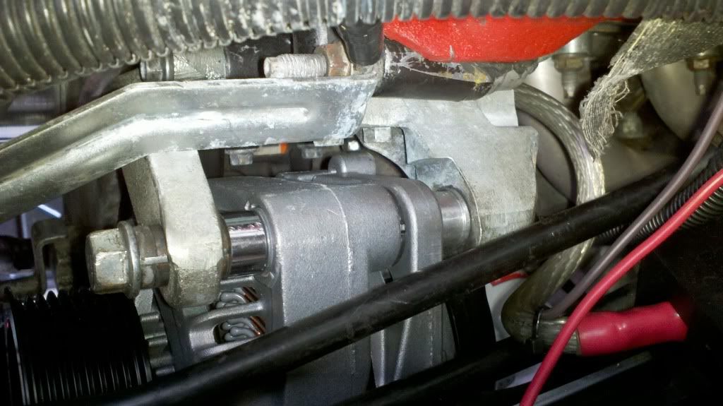

    The fololwing pic is not the final configuration. I made my own spacers thinking Adams measurements were off but in fact his were dead on.
    Now the good stuff....start up.
    I **** you not I put a volt meter on it and it never budged from 14.6....not even when I revved it 4k+
    Went out (86 degrees out) and drove it hard for about 20 minutes. IAT's got in the 150's, just to tell you how hot it was in the engine bay. Battery voltage was rock solid at 14.6, but the Aeroforce read 14.0-14.2
    Here is where the dats gets interesting:
    I had a meter on the battery I was monitoring. It never moved more than .1 volts no matter what the rpm.
    The Aeroforce gauge however went to 13.6 on one WOT pull at 6k+ rpm's. AND this was with the headlights, fogs and AC on full blast!
    The alternator works, and it works well. I wish I had weeks of testing to provide you, but I dont.
    I do know that if i had a stocker on it, at those temps, the voltage would have dropped to 12.0 or lower on the Aeroforce.
