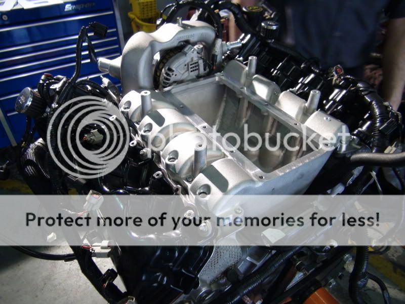

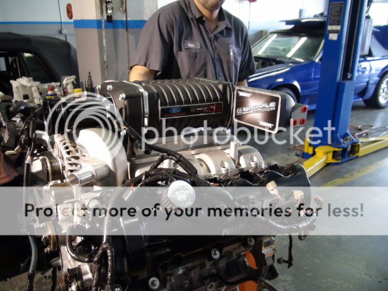

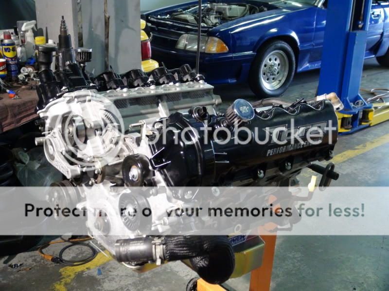

I just wanted to share this with everyone on MF....this is a build we are currently finishing after our customer spun a bearing a few months ago with his N/A setup that included these same heads, cams, FRPP Intake Manifold & TB, which made 370+RWHP on our Mustang Dyno. I just wanted to post here about the build and the first starup video. We have a couple small things to take care of before it hits the dyno:
298CID Whipple 3V Mustang GT, Torq Custom Cams, Torq CNC Heads - First Startup Video
Torq Performance Engines Custom 298ci 3V Engine:
9.3:1 Compression
New Aluminum Production Block
Forged Steel Stroker Crankshaft
Mahle Forged Pistons
Mahle Rings, Locks, and Wrist Pins
Manley H-Beam Rods w/ ARP 2000 Bolts
Clevite Tri-Armor Coated Bearings
ARP Main Studs
FRPP High Volume Oil Pump & Pickup
Canton Road Race & Track Deep Sump Pan w/ Baffles
Brand New Hardened Sprockets & Gears
Brand New Timing Chains, Tensioners & Guides
ARP Head Studs
Ford MLS Head Gaskets
3V Adjustable Cam Gears
Stage 2 CNC Ported Heads (carried over from his N/A build to keep costs down)
Stage 2 N/A Cams (carried over from his N/A build to keep costs down)
Whipple 2.3L Supercharger with Whipple Dedicated 10-Rib Pulley System IAT sensor relocation
FRPP Throttle Body
Kooks LT Headers w/ Catted H
Magnapack Catback
Afco Dual Pass HX w/ SPAL Fans
Injector Dynamics ID725's
FRPP GT500 Dual Fuel Pump System
Almost everything has been replaced with brand new OEM or Aftermarket Performance Components.....the ONLY component being carried over from his old motor is the water pump.
Blower on! This motor is going to be awesome!
