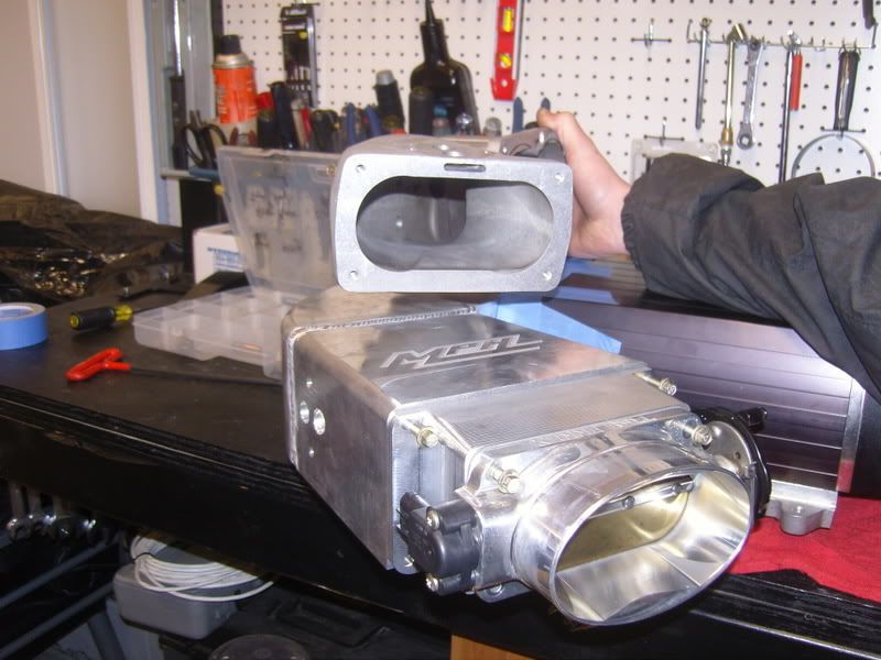

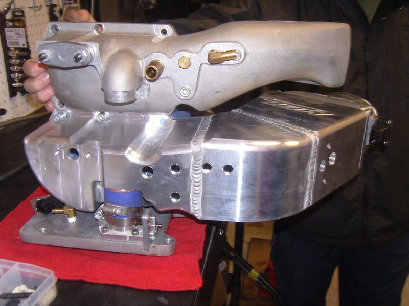

Took the blower off the car yesterday to start getting an idea of the difference between the two. Now I know some of you guys want dyno numbers and that is it but for the some who would like to see the phyical differences here are a few pic's.

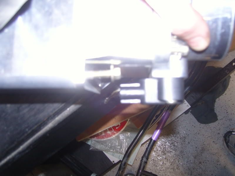

I did this for ref to make the new TB cable since I am going to be running the single blade TB plus you can see how tight it is going to be to get the TPS harness on with the adapter plate.

I dont get it. Why run the big intake with a small t-body?
5,800 Posts
Because every bit of data I have ever seen (Kenne Bell Site, Accufab Site, RPM Outlet, Laws Phyics calculations) shows that the Single Blade Throttle Body flows more than enough for 26-28psi on the Kenne Bell.
Do they make a tb that will fit it without the reducer?
Yes. We are running the reduce in case Kenne Bell proves all the data on their website and accufabs and billetflow, and laws of physics to be wrong. Then we can upgrade.
There are two versions. One for the twin 75mm and one for the single blade. You can buy the Dual 75mm one and just add the reducer so you can run either.

I understand all the info but why does KB have a bigger T/B on the Mammoth version of the 2.8? What are the Mammoth's rated for boost? Or Blower RPM would be a better measurement correct? Since boost can vary from car to car?
5,800 Posts
Because people think oh its bigger must be better and must be needed so the parts sell so the deals sell them. Accordding to KB website and according to the mathmatical equations the KB flows around 1560 CFMs at full boost which is 26psi. According to all the websites the Single Blade TB flows over 1600 cfms.

On a side note I cut the $150 added to $10. Got the TPS extension, IAC sensor, and trottle cable all for $10.
