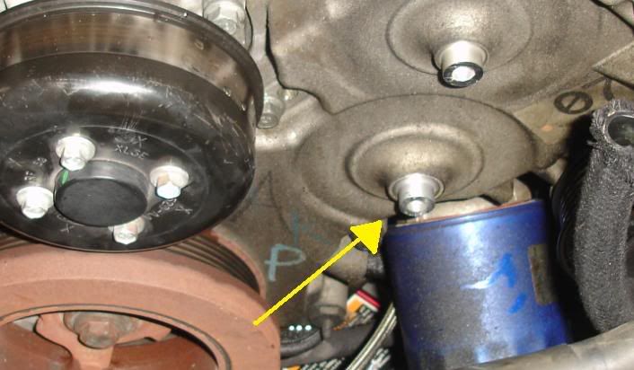

I've got an extra idler lying around (90MM, IIRC). Can I simply swap the smaller Saleen pulley on the alternator bracket, or will it rub/hit something?
Here's an old picture from the middle of the Saleen blower install. The idler with the arrow pointing to it already has a 90mm idler (I think.) Can I put one in the empty hold above?
I've already got a 1000 mile new upgraded tensioner (from BBR) and a V10 water pump pulley. (Not in the picture above, but I'll pull the air box assembly and take better pics later.)
