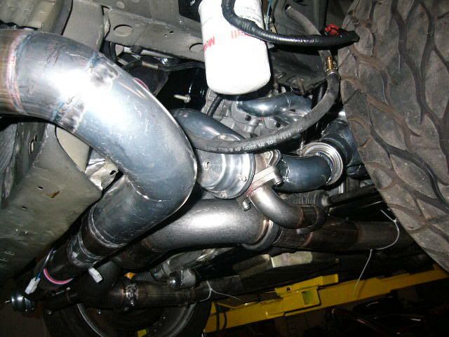

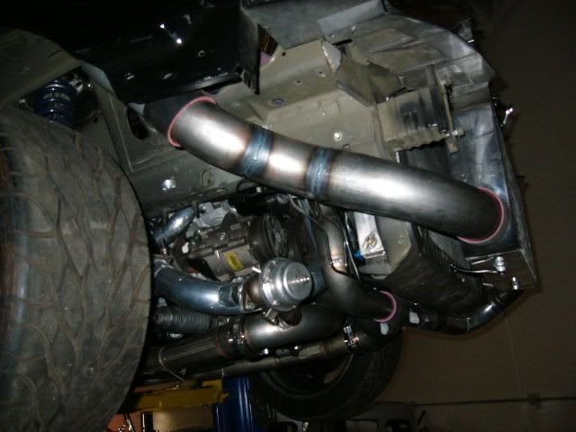

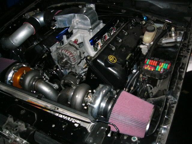

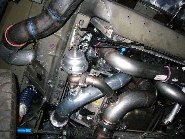

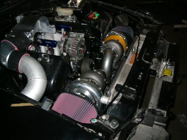

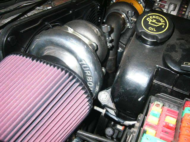

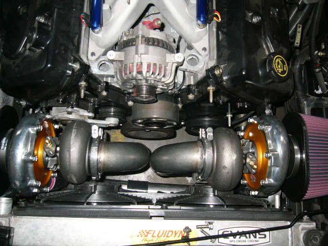

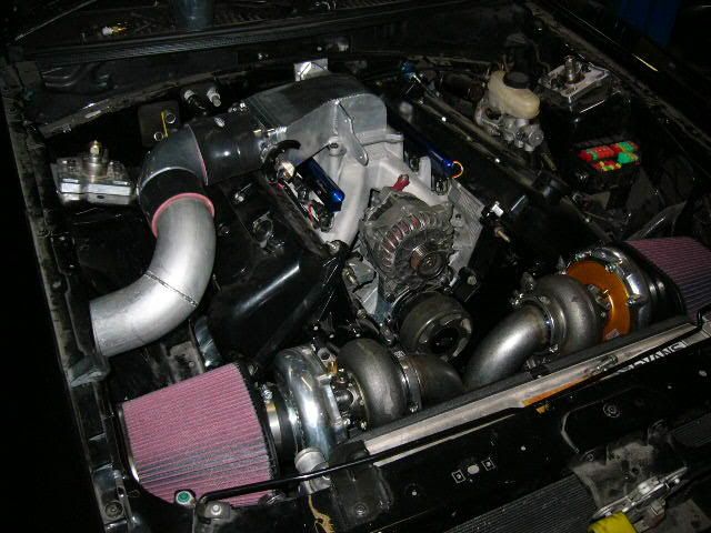

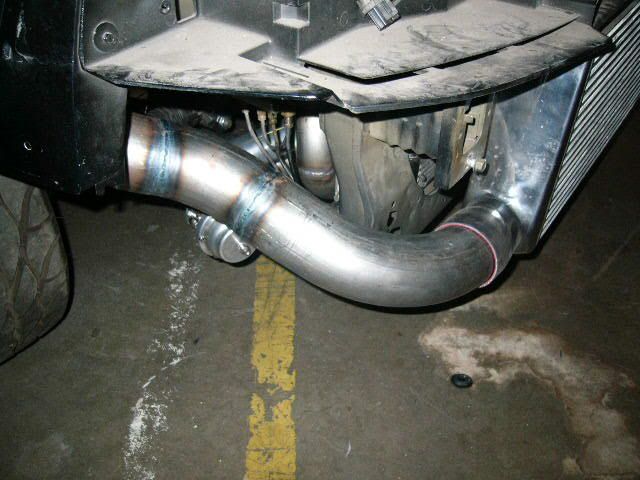

Ok great people of the mustang world here is some shots of a 2004 cobra that we just did a custom turbo kit on this is a twin 67mm turbo set up with our custom kit, should make about 1400.00 the car is equipt with DFI , g force t56, and a 9" rear end

31 X12X4 and it works perfect out 5.4 that we did had a 105 IAT temp at 20PSI so it works perfect
That cooler is rated well below what your goals are. I know they will work, but working efficiently is a different thing. I use them all the time just not on 1400 hp cars.

Looks like a HPP kit?
How in the hell does it look like a HPP kit??? Two turbos and Two air filters???????:rofl2::rofl2:
Ask Jim Napier who's HPP's kit looks like.:tip:
we made 1100 on wicked 03s cobra with that same inter cooler wth no problems and the IAT 2s were low 105* that sound quite efficient to me. So in a street set up it works quite well with no issues. Now track only cars all get air to water

You tell me?
Pssssst..............I have a HPP kit!
It looks NOTHING like a HPP kit............other than what I said..........TWO TURBOS AND TWO FILTERS!
AGAIN..........Ask Jim Napier who's HPP's kit looks like.

uhm i use t-4 not t-3/t-4 turbos are lower and sit more in ward and i dont see any wast gates sticking up

Ok, I am wrong :dunno2:
The THP turbo placement is the same, but there intake piping is different. No biggie... :bigwink:
this kit is completely different. I did use Wild Bills hat and that is HPP the only reaso i used it was because Bill wanted my Sullivan top
