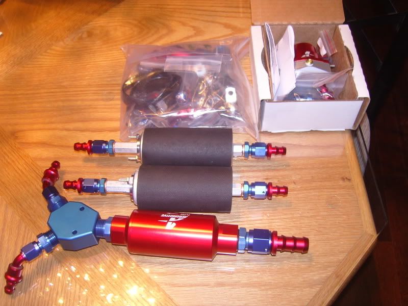

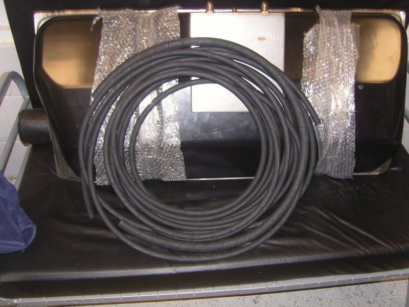

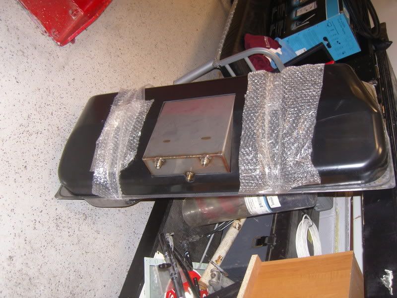

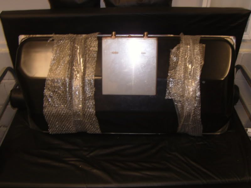

I recieved my Glenns performance 1000hp fuel system today. It consists of a rear sump in a new factory cobra tank, which the sump looks top notch and it all stainless steel. I feed line to the pumps is a -10 then there are 2 -6 lines to the front of the car, one from each pump which will feed each rail and 2 lines over to the reg. One -6 line to return back to the tank. I opted for there smooth tank shield which they cut out for the sump and the stainless steel tank straps. I just hope I will not need the triple fuel pump setup but Glens states it will be more than enough to support 800+ to the tire which I I do not expect to come near. If I make 725rwhp I will be shocked!

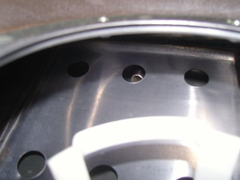

As you look through the top of the tank, is there anything besides the 6 holes there that allow the sump to communicate with the rest of the tank??? And are there any other sort of internal baffling/walls?

The 1000hp system is $1,299.00 but I opted for the stainless sump, there shooth shield and the stainless straps which came out to $1,769.00 shipped.
If you look down into the sump you can see the baffling.

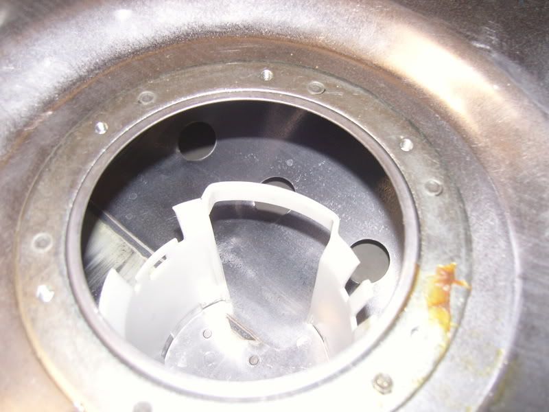

What I am not sure of is what that white piece of plastic is right where the sender go's.

If you look inside a GT or Mach 1 tank you will see that white piece also its the fuel pump basket.

Oh so this is not a factory cobra tank, they cut the larger opening in the top for the cobra sender. I is either a GT or Mach tank. That explains that one. Is that basket going to interfere with the Cobra sneder? I would think so.

They are Spectra Premium tanks manufactured in Canada, and the same manufacturer who Aeromotive uses. Glenns just throws there stuff in there. Essentially its a stock tank other than the area that Glenns add, ( sump, baffles, internal pick-up tubes, etc... )
