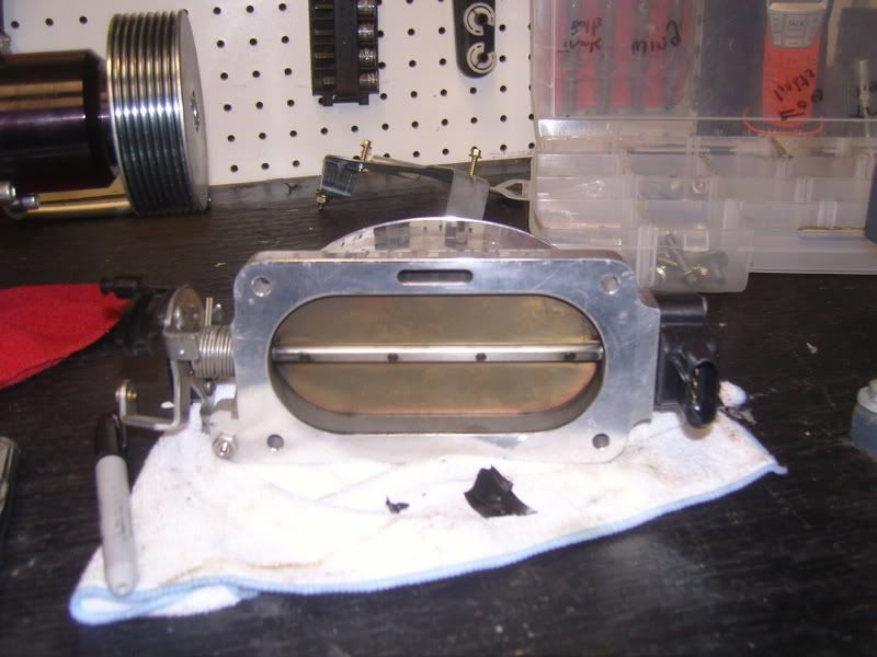

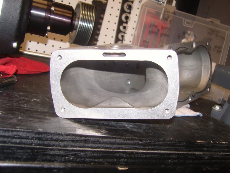

Today I was measuring to have my new TB cable made up and I noticed that the idle air bypass is now located on the side of the intake and both holes are drilled all the way thru into the intake track. The KB intake has it on top and the second hole has a passage tunneled thru intake to line up with the slot in the TB for air to the idle air bypass. This bypass is now blocked on the TB because it doesn't exist on the Behemoth so how is this going to wor and what is the point of even having it on there? Now I guess we need to have the idle adjusted thru the TB blade?????

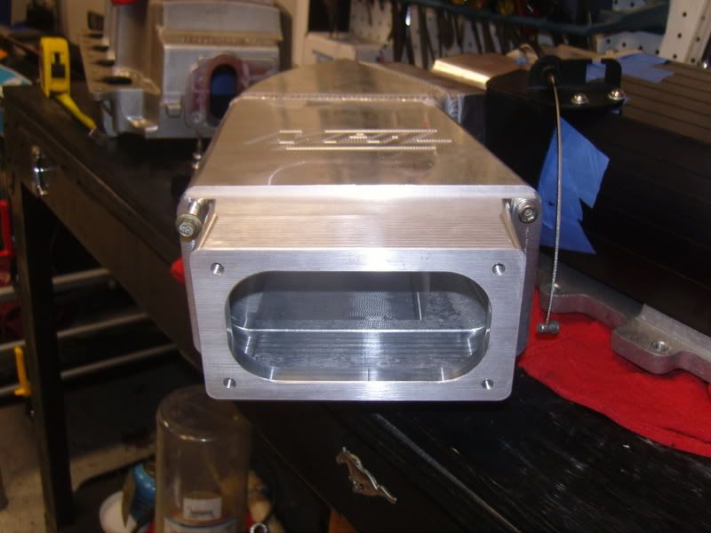

If you look at the last pic all the way to the left side of the intake you can see the 2 holes for the idle air bypass.

So what do I do so I do not have idle issues?Id the TB blade is closed there is no way the car will ever idle? Do I drill a small hole in the TB blade???

Get a IAC for a 03 GT part# 2R3Z9F715AA . It will plug in the IAC harness on the Cobra and it has a hose fitting coming off the IAC that you will have run from the IAC and tap it into your CAI in front of the TB using a hose . This will bypass the air you need when TB is closed. I did my inlet this way and it works great.
