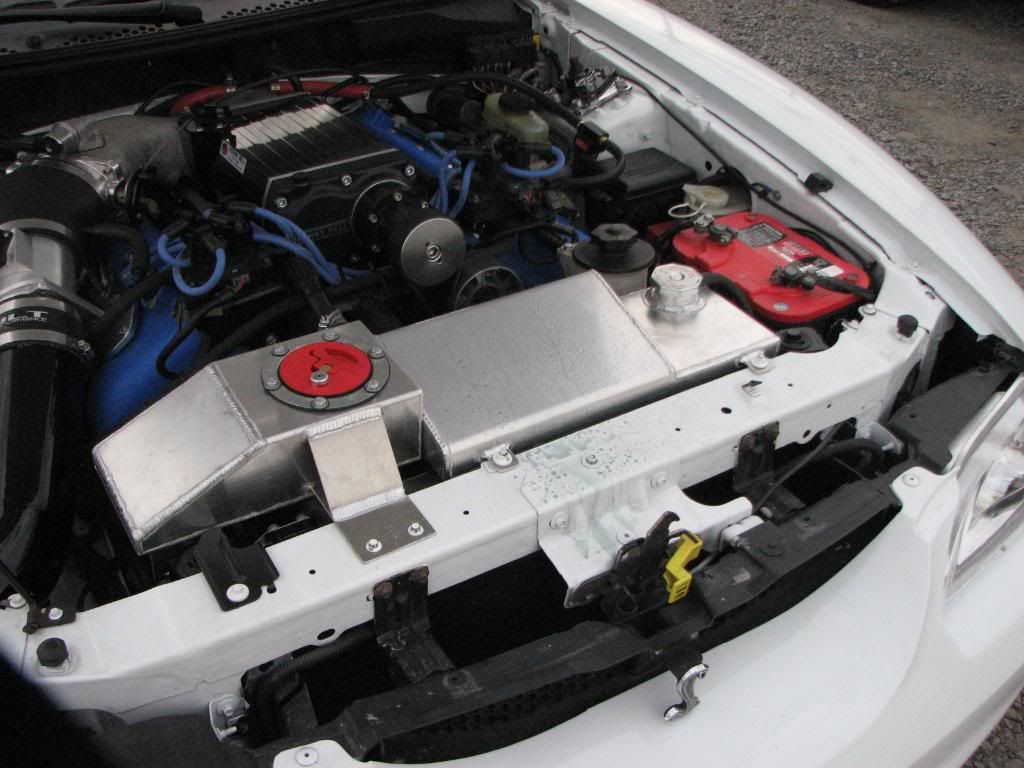

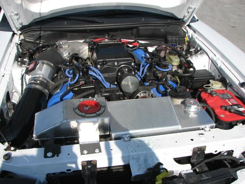

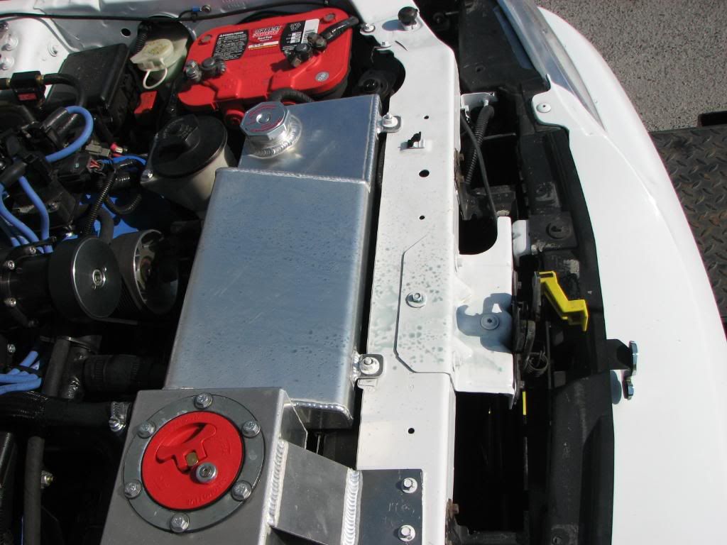

I checked for restrictions in the fenderwell and the bottom of the filter
was closed off so I trimmed off the plastic inner fendr to open up any
restrictions but I am still only seeing 15lbs. boost max @ 6500rpm.
Attatched are a couple of pictures of the set up. I cannot see any
restrictions now that might still be creating the problem. Boost reading is
the same off of my PMS and my boost gauge. Take a look and see what you
think this is a bit frustrating since I bought the blower brand new in
August 08 it has about 1200 miles on it. I would like your advice on what to

what type of kit is this, cobra, 05-up GT or 2 valve GT? is it a stock
displacement 4.6? does it have cams or any type of head work? the headers
will cause you to lose a pound or two of boost. what size crank pulley are
you running?

I kind of skimmed through the emails. But if you want a warranty you may have an issue. KB has strict dealer contracts. First strictly wasnt supposed to sell you that blower without installing it (Per KB, thats part of their dealer contract). Now you had CJs install it which may make it even more difficult. The line off the back of the intake manifold to the blower shouldnt be a problem. I run it on all KB cars with a PCV and they hold boost no problems. Gone as much as 25#s without issue.
Who installed the pulley on the blower? Was it torqued properly? If not the pulley will spin on the shaft and cause a boost loss. Is the belt tight enough? What is the position of the small reference tab on your belt tensioner?
Did you check the bypass? Is it staying closed under boost? Make sure there is nothing obstructing the arm for the bypass to maybe get caught on.

SGS Performance installed the pulley and they did install correctly. Belt is plenty tight no slip or signs of slip. Not sure of the small reference tab I have the blower off of the car now. As far as the warranty Matt @ KB said no problem your under warranty in one of his emails. Question for you What must be done to fix the blower now? Bypass was fine.
