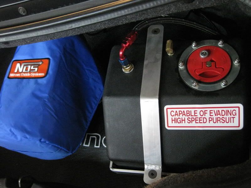

Had a local peformance shop to add more mods to the stang,
latest mods,
-Installed procharger 8 rib kit
-T-56 6 speed
-Ford racing aluminium driveshaft
-Spec stage 3 clutch
-custom made 3 inch H-pipe
-Steeda ajustable upper control arms
-Lower control arms
-Steeda sub frame connectors zinc
-#20 braded rad hose
-Fluidyne 3 core rad
-Long tube header wrap
-Snow stage 3 water/meth injection
-Custom braded lines and fitting
-Custom tank for the meth with low level sensor in the trunk
-nos nitrous system installed (have not tune with yet,waiting next summer)
-Autometer shift light
-Nos switch installed
tuned the stang and it made 570 rwhp and 470 torque at 21 psi on a built 2v motor(not trying to push the stang to the max).We are gona replace my stage 3 blower cams to stage 1 cams next summer to get more torque and also tune it with the nitrous system at 100 shot more even more Hp hoping to reach 610 rwhp..lol

How do you like the remote meth tank? That would be great for my car. I run out of meth so fast and there's no room left in my engine bay for a bigger tank.
