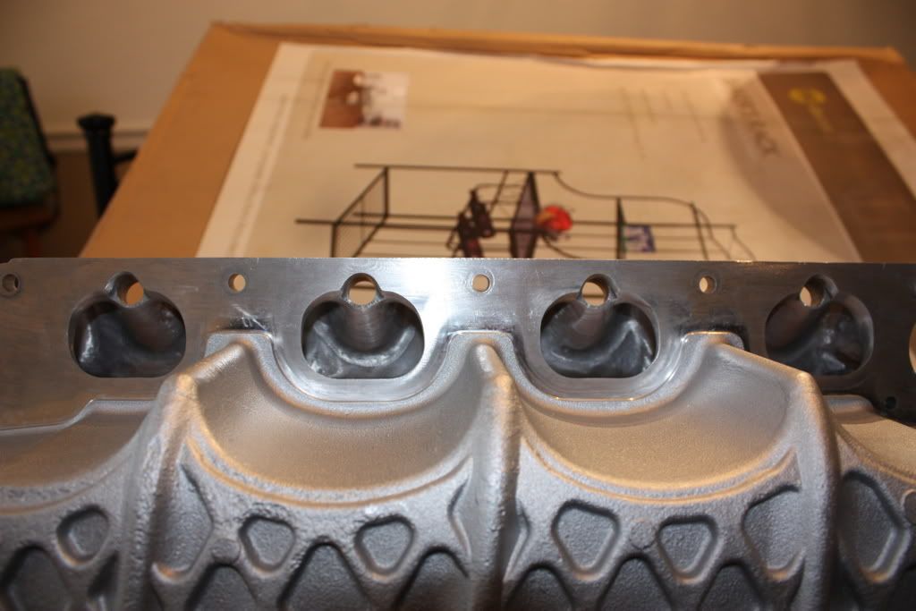

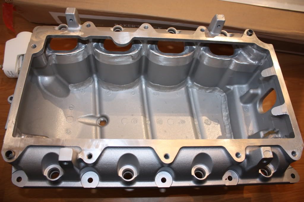

Well I just got my Nazty Performance ( www.Naztyperformance.com ) lower intake in. Just like all of the other stuff done from Nazman this piece is top notch. Very well done. I am hoping to soon do a before and after dyno with this being the only changes.

This does not add any clearance between the intercooler core and lower intake. What he does is add a epoxy to radius the edges to the air doesn't hit a "brick wall" after coming out of the intercooler. He also gives it a high temp coating as well as cleaing up the injector bosses and where the ports meet the heads...
5,420 Posts
And by adding that epoxy will make that much of a difference? Looks like a real nice neat job. I have to get mine over there.
