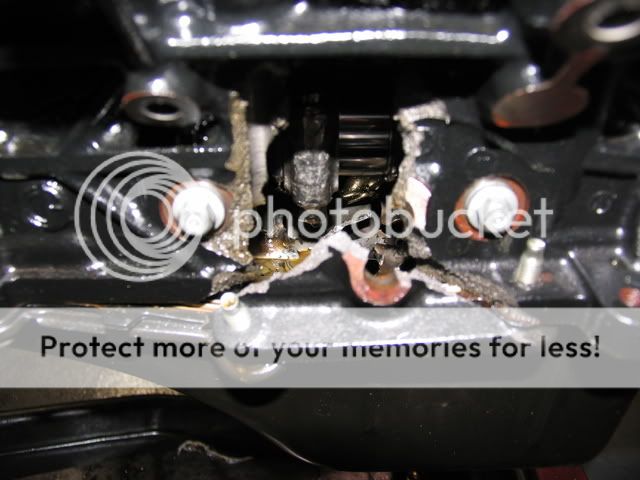

Most of you probably remember the "GT800R" project. When the car was built, we planned on making 800 crank HP, hence the name. The customer wanted to push the limits and the car made 815 RWHP. We told him that at that level, it wasn't a question of if it would break, rather when it would break. Well, it broke... and it broke good.
The Car.....

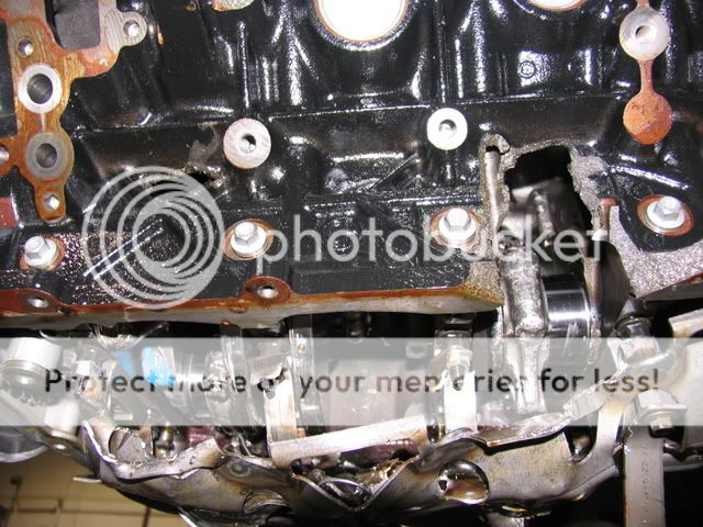

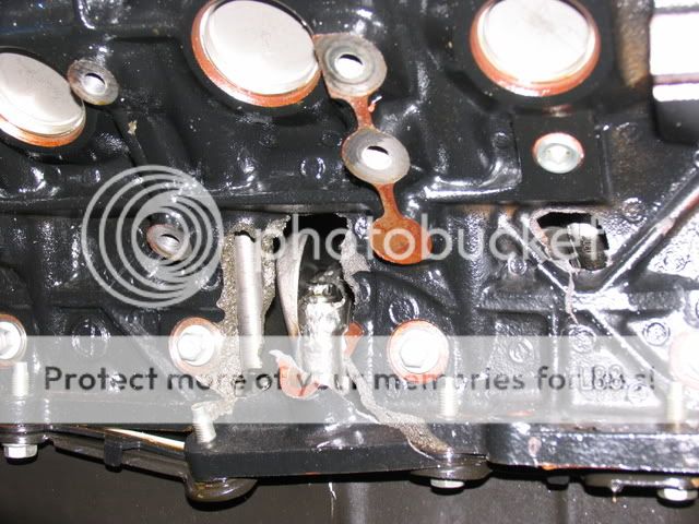

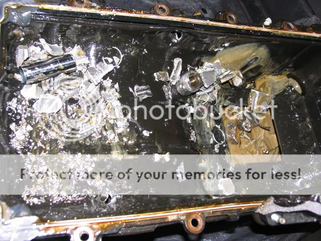

The Carnage from the Old Engine.....

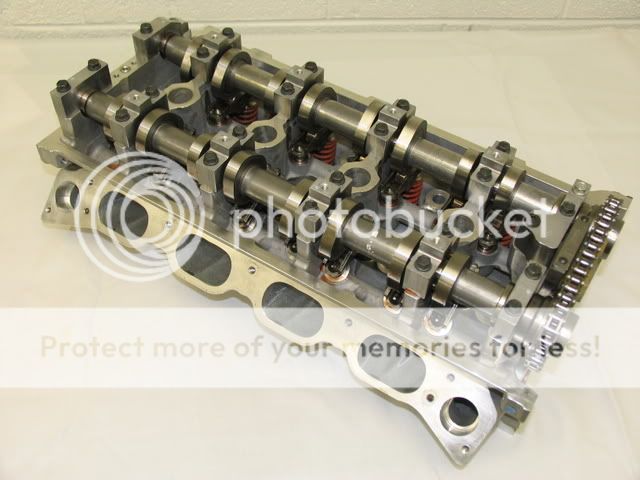

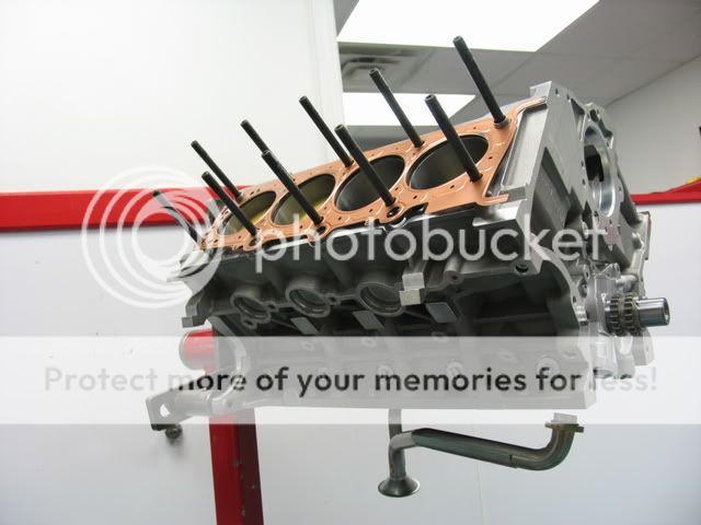

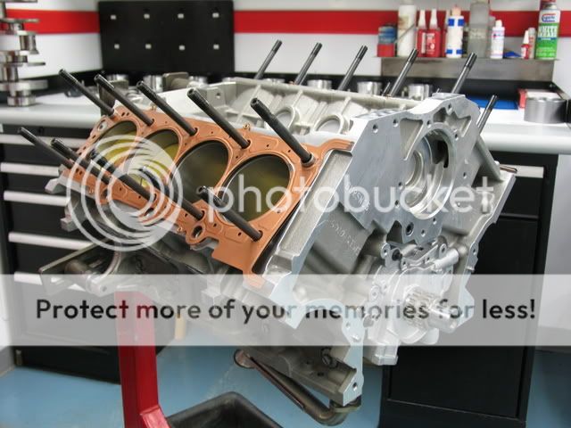

The New Engine.....
Specs:
  • Livernois Motorsports Built 5.4L Aluminum Longblock
  • GT Supercar Aluminum Block
  • ARP Pro-Series Studs
  • Carrillo H-Beam Rods
  • Custom Diamond Pistons Engineered by Livernois, Manufactured by Diamond

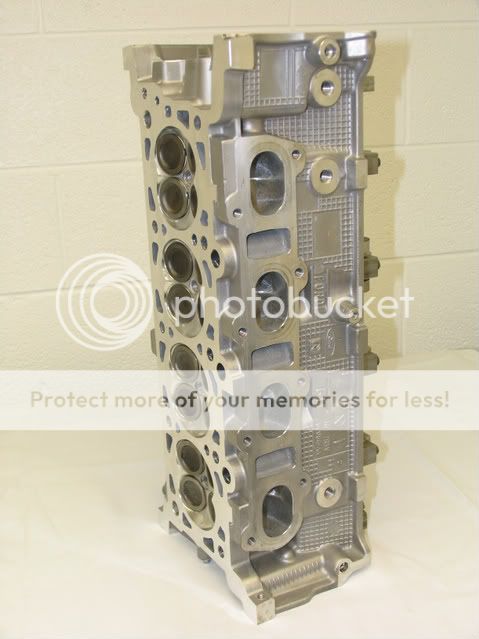

  • Livernois Motorsports CNC 4-Valve GT Supercar Cylinder Heads
  • Ford GT Supercar Camshafts
  • Canton Oil Pan

nice hardware! stock stroke and bore?
It is a prduction bore size, and the stock 4.165 stroke as well :bigwink:
That new engine is sweet, engine porn to me lol, Rick what head gaskets were those SCE???
It is a cometic MLS head gasket with copper spray on it, this is standard practice for use to ensure zero coolant leaks...
