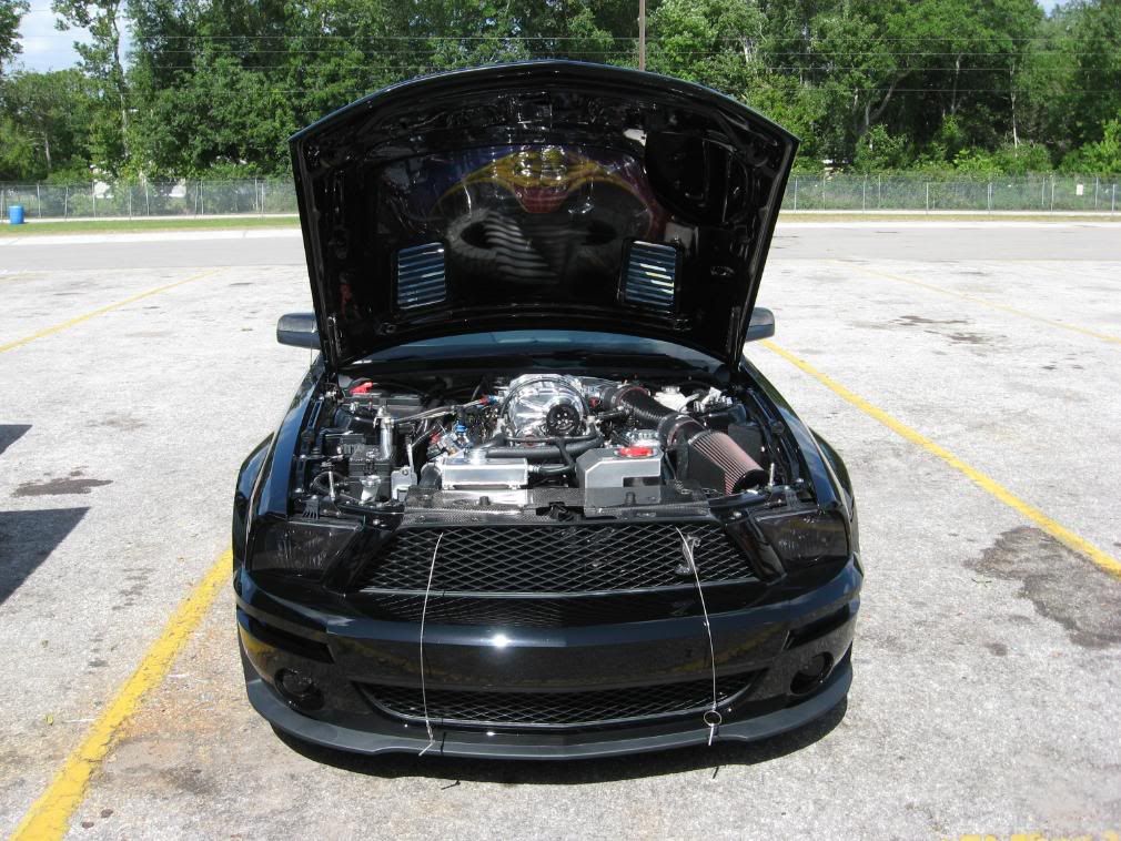

We got a chance to give Vic's GT500 a few shakedown runs and were impressed by the MPH, though getting traction proved difficult =o)
Below are some pics:
More pics and full story here: CLICK HERE for DDD Directory Blog
As of now, it's making around 680 RWHP on pump gas.
Thanks again to ModularFords.com for being involved in this project....video coming soon!
Next: Hoosier drag radials and gear swap (going back from 3.73 to a 3.55 or maybe stock gear to see what happens)
Jim

Do you guys see any problem with the fuel crossover line contacting the blower? I don't mean a fire risk (although that might be a consideration), but rather heating the fuel unnecessarily by being in contact with the blower when it is heat soaked?
Just wondering.
Just wondering.
Def might me a concern.
The blower gets HOT. Noticeably hotter than the Whipple on Chris 03 cobra.
May have just been the sweltering outdoor temps on Saturday........

Awesome car! looks gorgeous under that hood.:worthy:
I have the same set up only its even worse with 750 rwhp - waiting on MTDR's before I return to the track! You did better than I did! That is a great looking engine compartment for sure!!!!:good:
Thanks Fatchile! I wish i could take credit for the car, but it's a customers of Jake LaMotta here in Orlando. His name is Vic and he is a great guy, he loves to go to car shows and play around int he car, but when it comes to taking the car down the track, he's alittle intimidated witht eh car and would rather let someone else do it.
