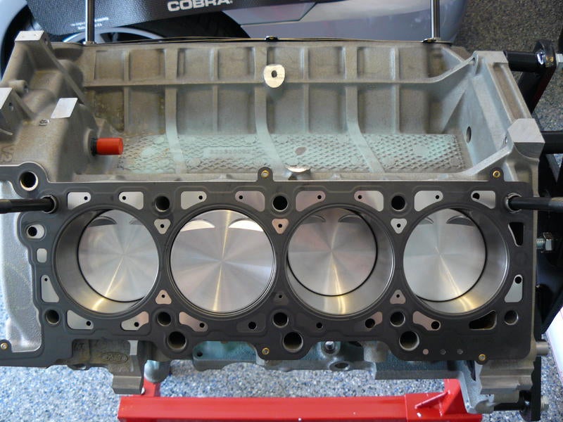

Anyway, the short block getting ready with the Fel-Pro 26187PT & 26222PT MLS head gaskets and just TWO studs at each corner for ease of setting the heads down. You don't need to actually thread in any studs before setting a head down (that's what the locating dowels are for), but I wanted the two in there in case either one of the heads slipped out of my hands! I also set the crank position with the holding tool (from the OTC 4.6 tool set), which put pistons #1 & #6 at TDC. You can also see the new coolant inlet tube and head dowels, which were part of the FRPP M-6026-A46 kit:
Just for the heck of it, here's a shot from underneath, looking at the #7 piston which is at BDC. The wrist pin (tool steel from Gibtec, by the way) is close to the bottom of the bore, but not beyond it in any way like with a stroker:

All done, with the timing chain guides added as well:
Stay tuned for the rest of the timing gear!
This is one great upgrade Joe! Thanks for taking the time to document it with both words and pictures.

Well since I'm using the factory cast iron block, would 85 still be a good number or go higher? I'm just a victim of the 90s 5. 0L stuff and you had to torque the head studs down until they almost broke if you wanted to keep the heads from lifting off the block from all the nitrous we were using. And even that seldom worked (o-ringing the block was the only real cure). So I assume 85 would still seal up plenty good for 18+ lbs of boost?
#19 ·
That, I couldn't say for sure. You know who will be able to answer it, though! Otherwise, a call to ARP should get you the information you need.

#62 ·
I put mine at 90lbs on my Teksid block. Let the motor sit for 24 hours, loosened them then torgued them again. It's been over 5 yrs now (DD) with no issues what so ever. And im at 842rwhp on pump gas.
#24 ·
I wouldn't say "only" 85 ft/lbs - that is plenty. If you use the standard 8740 studs, the number is lower - as already mentioned. There are plenty of guys using the OEM MLS head gaskets with factory head bolts and running much higher levels of boost than I ever will.

#30 ·
On my car I'm running the 8740 head studs and the instructions they came with said torque to 80ftlb. These head studs were purchased back in the spring of 2015. I'm running them with Felpro
Part # 26222PT (right)
Part # 26187PT (left)
head gaskets at almost 23 psi on my terminator. So far no issues *knocks on the wooden desk*..:)
#32 ·
Ed, very good info on the torque specs. 85 ft lbs it is. Like you said, these mod motors are in many ways superior to the old push rod v8 SBF's of yesteryear. And it seems that head gasket sealing is one of those areas since it is rarely, if ever, reported someone experiences a head gasket leak/failure. I'm just being paranoid since I fought that for years back in the 90s. I distinctly remember with vivid clarity putting those motors together with head studs torqued to a ridiculous amount and Fel Pro 1011-1 head gaskets and as soon as you hit the second stage of nitrous, you got a gallon of coolant splashed all over the windshield from the heads literally lifting off the block and compression flooding the cooling system... Good times lol.
Great documentation Jr. Like someone else commented, these build threads never get old. Your build is very impressive. Your meticulous attention to detail in admirable. I wish I had the cash flow to fund some other parts, but I have spared no expense on the must have parts. For what I'm doing and the power level I'm at, I'm quite certain that with good fuel, this will be the first - and last - time I have to do this... Lesson learned, albeit the hard way, for me ;)
